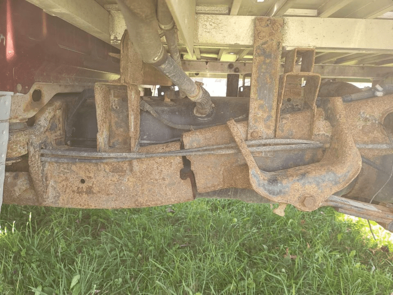

2012 Ram 3500 for sale, on FB Marktplace, near me with 434,000 miles. Has a broken frame as shown in Picture below. Looks like a clean break. Maybe a weak spot in the frame right at the hole? Plus a diesel pulling hard in low gear with say a 4.10 axle puts a huge up twist on the frame at the front spring hanger.....
Yeah, that. Make the frame longer, then put a drivetrain in it with the torque just short of a locomotive, overload it cause you certainly can with all that, then drive like you're at the tractor pulls everywhere you go. What could possibly go wrong???
Unless the rust is worse than it looks, a good welder should be able to patch/plate that break.
If the truck is cheap enough, might be worth a try.....
You couldn't pay me enough to fix that frame. The steel these companies use today is to light. That frame is not strong enough to hold what a dual wheel one ton truck like that should be able to carry and mind you its a aluminium flat bed
I had a early 80's GM C30 with a 10 foot steel flat bed, a rack to carry steel, under body toolboxes, full size oxygen and acy bottles, 1500 pound welding machine, plus tools steel cables and there was never a problem with the frame. The frame on that truck was a heck of a lot bigger thicker than that thing that broke, ridiculous how light they make these frames and that's not the first ive seen break at that point
That truck needs a to have the frame replaced, its the only way.
If you google the wet weight of that specific camper is says 6,090. So yeah he for sure overloaded it is the payload is only 5,950. Plus what else he put in there. Looks like those were designed for the 4500-5500 models which would be fine with that kinda weight.
Link? I’m local, hold my beer and watch me weld that up!!
Would really like to pictures of the frame on that Ram. Wonder if it's buckled or fatigued and broke(guessing fatigued and broke). Regardless a new frame is in order as everything around the damaged area is also weaker now.
My 99 Chev Silverado broke the frame both sides just in front of the rear spring hanger. The frame has a similar oval hole in the vertical side rail. In line with that there is a 1" hole in the top and bottom of the frame. What the truck was used for before I got it I cannot be certain. I did have to install a trailer brake controller to tow my car trailer. When driving with a load I always slowed down. Obviously these are a weak spot on all makes. Then you throw in the calcium chloride they pour on the roads these days for icy conditions, corrodes the steel bodies like battery acid.
I would more blame the camper designer than Chrysler. There is more to it than just weight, which apparently exceeded the vehicle's rating regardless. I too suspect an fwd-rear rocking oscillation which broke the frame from metal fatigue, like bending a paper-clip back and forth. Might occur at certain speeds, dependent on the moment of inertia of the camper and spring-rate of the suspension.
