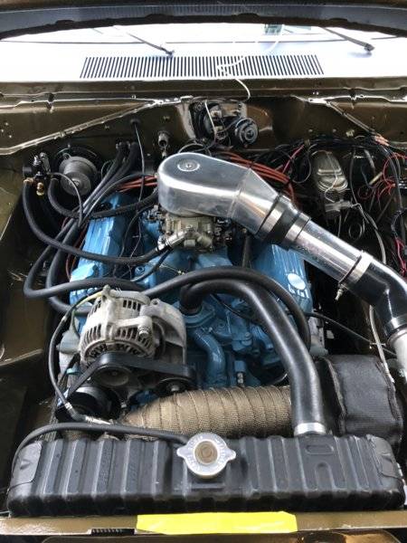

Another small block turbo early valiant
I'll look it up,thanks. I'm not sure if I want single or dual just yet. I am open to any suggestions since this is a new realm for me. Merry Christmas and Happy Holidays

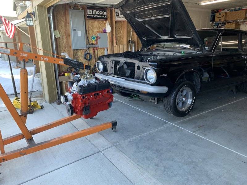

So I got another head all together and re assembled the engine. Fired it up and it developed a valve train noise during break in. I’m gonna pull the rockers and intake tomorrow but I’m thinking I lost the cam during break in. Seems like every time I make progress something comes up to kick me in the nuts. Haha starting to loose sight of this thing hitting the road in the spring.
I hear you on that, at least yours is running. Dont let it sway you, you've done some great work, better now then driving down the road or freeway and it let's go.

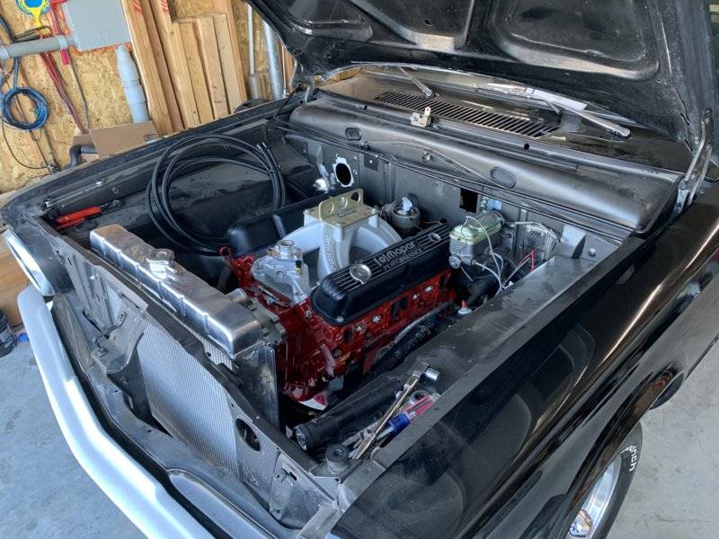

Well I made a little progress today, got the home and in!
Looking good!

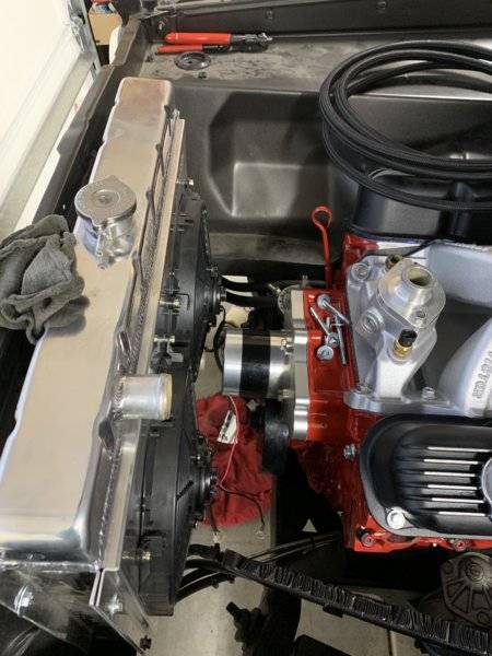

What elec water pump is that? Looks familiar. Does it allow more space than a stock water pump?
Looking good!
It’s a moroso pump I got from one of the members here. It has good clearance probably 2” between the fans and pump.

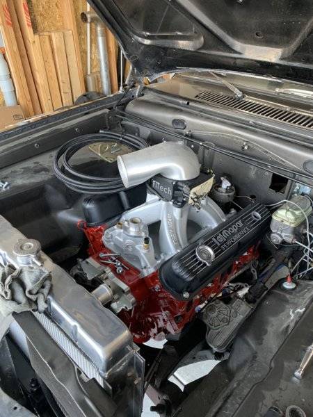

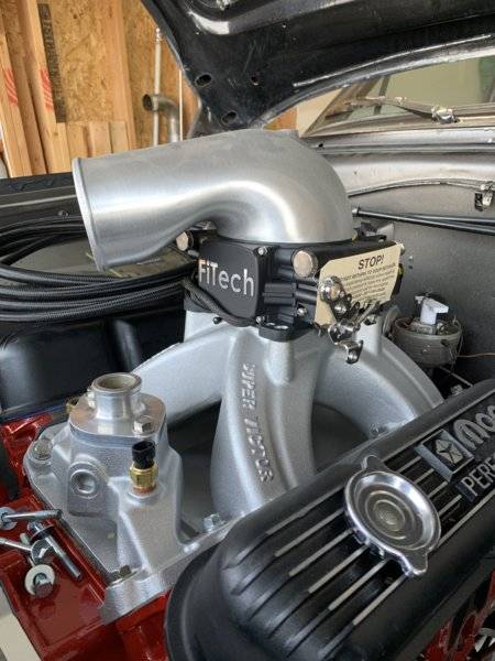

Ran a dry fit to check hood clearance.... that will be an issue. Anyone using a shorter carb hat they are happy with?
Your intake manifold is the hood clearence problem. Lol a regular torker would work fine, you are force feeding the engine so the super victor is overkill in my book. Just my 2cents
not overkill with boost, I agree though a shorter intake would solve it. I just can't justify buying another new intake.
Looks like you are already running a low pro style hat, you will have to be careful trying to go anymore low pro, guys have had distribution issues from trying to force the air into such a tight turn before the carb/throttle body.
VFN fiberglass, AAR hood will take care of that and look cool as hell doing it! See Violent Valiant :thumbsup:
It was a little generic, did that on purpose. Most people just want pictures anyway. Pm for details
I agree, there are people leaving a ton of power on the table with poor hat design. Procharger and extreme velocity are the two best ones out there. The super victor is a great choice for boost. You have to remember that boost is multiplying your base hp and the more base you make the less boost you need to make your goal and if the flow path is good it'll make the turbo work less and that means less heat and less heat means less detonation. Another tip to remember is that the carb hats affect A/F from cylinder to cylinder so be careful with your tune up. The left rear cylinder will run lean with the hat on like it is in the picture.
I don’t see getting around cutting the hood. I’ll probably end up getting a better hat. I appreciate they input. What do you run for ignition? Will a stock electronic ignition work or is a Cdi box worth putting in? I’ve got a 6AL but might just go back to mopar electronic if I will do.
