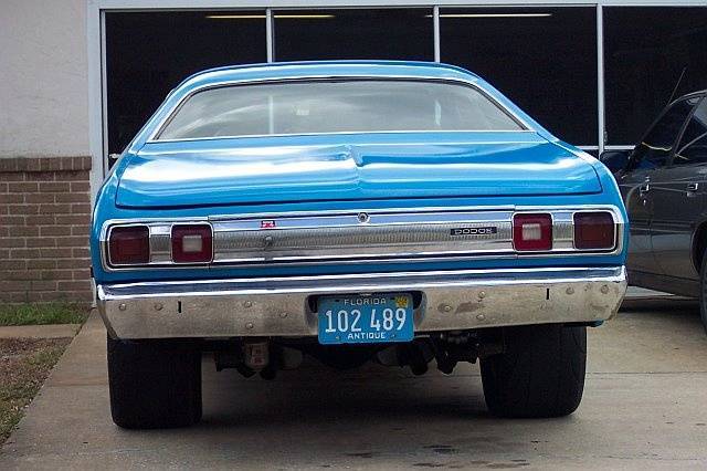

i think it looks pretty cool. It’s pretty neat how the 73+ dart sport tails are square similar to the 67-9 as well. It would be cool to eliminate the reverse lights in the dart sport and come up with a way to integrate the reverse lights into the turn signal/brake lights
