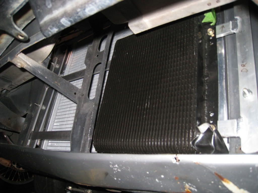

Here's the one we made for my car.
This is basically in reverse order from finish to start:
