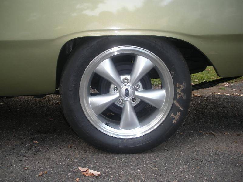

I just installed B body 8 3/4 rear end in my 71 Scamp.. Fits well. Grinded off old perches, set on new onesand installed without welding for now. When 440 and tranny is in and I'm ready to measure for driveshaft length I'll set pinion angle to 5' and weld.
P.S.... Have 2007 Mustang Torqthruster rims in it for now. They had the perfect offset. They Are 17"X8" 6.295" backspace and 45 mm offset. Almost positive of the numbers, But I'll measure backspacing tomorrow and post more pics
