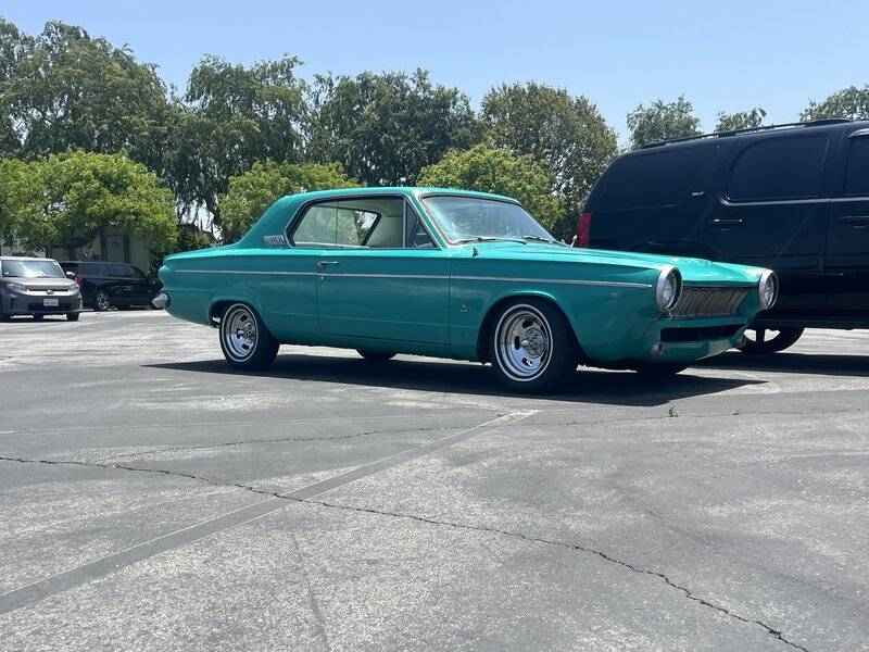

Did a 186 mile turnaround to Ventura Nationals this weekend while I wait for parts to arrive to do the swap.
