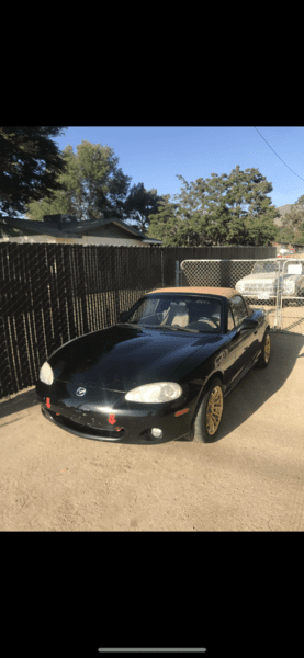

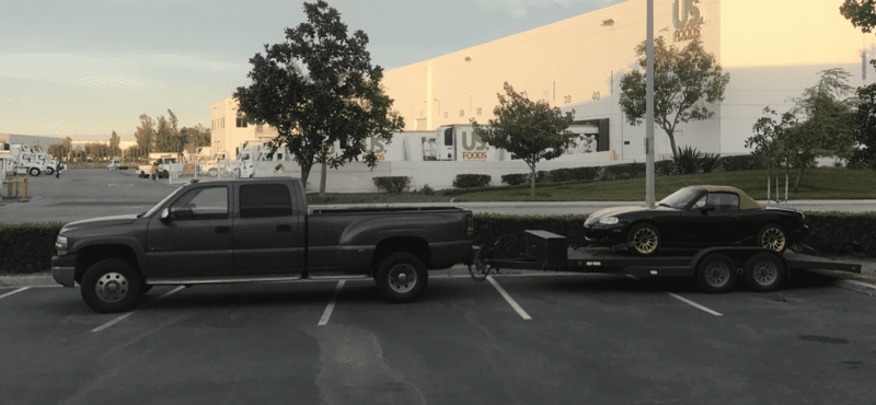

Tru Dat, and the Miata is not the car to go the bar and pick up chicks in, but at the race track they womp up on much more expensive, much higher hp cars. They really can be very good.
