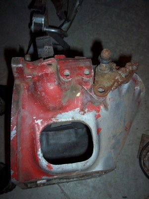

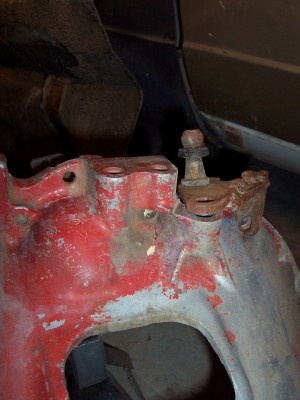

Anybody out there that is running a 10.5" clutch with a Mopar aluminum bellhousing. What are you using to support the bellcrank on the bellhousing? Years ago when I swapped in an aluminum bellhousing & 10.5" clutch from a 69 Dodge I used a piece cobbled together from the stock part that originally came with my factory supplied clutch & cast iron bellhousing & 273 V8 & 4 speed. It worked fine but looked like crap. The first 2 pictures below show that piece. Is there a factory part that properly locates the pivot ball? I once ordered one to fit the bellhousing I have & I ended up with the part shown next to the modified bellcrank in the third picture, but I see no way to mount it to properly locate the pivot either. I would also like to have a bellcrank that looks better than the modified one I have & I can't locate the factory pivot which fastened to the inner fenderwell, so I'll probably need one of those, too. Anybody have any part numbers, pictures or suggestions? Thanks!

Brewers has everything you need to put the bigger clutch in you car z-bar and the correct pivot thing. Anyways that's what there site claims.
