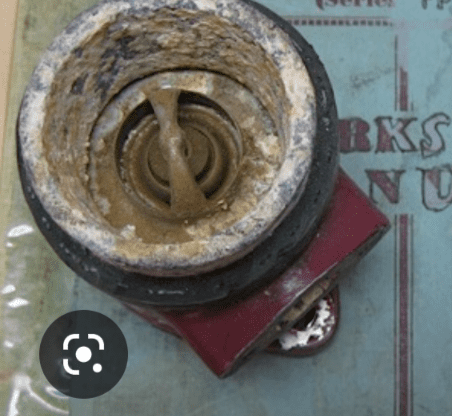

And your insides look like this:eek:

When you pull the engine out as much as I do it doesn’t get that bad. Whenever my car is “done” I might actually use some of the forbidden Mountain Dew
