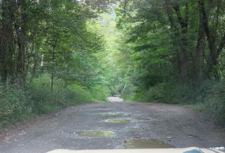

We have some bad roads too. LOL. This one is only taken by choice - there is a better road most people use, but there were some things I wanted to explore along this one.
