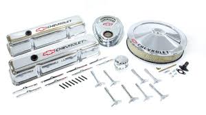

Best Top 10 Bolt Ons For a 318
  1. chrome valve covers,
  2. chrome air cleaner,
  3. 318WR sticker on the air cleaner (oops, that don't bolt on)
  4. chrome dipstick,
  5. chrome alternator,
  6. Yellow spark plug wires
  7. red distributor cap
  8. Yellow coil
  9. Chrome fan
  10. chrome breather cap
Like they always say: "If it don't go, chrome it"
