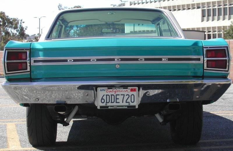

-- Gonna be tough w/an 8" wheel unless you get a special offset and install the offset leafspring set up. --
-- Yep ! -- Here's My 68 Dart with 8" modified BS (Don't remember the offset inches), and offset spring set up. -- 275/60-15" BFG tires. --SS Springs.

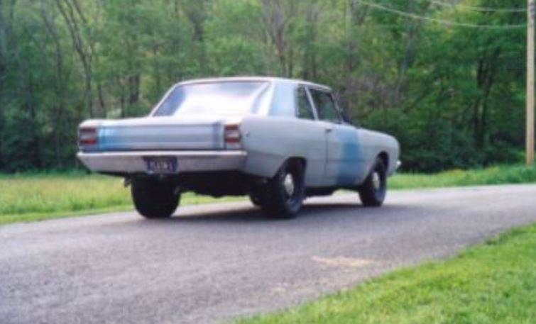

these were on the back of my 69 gt dart . 15x8x4bc 1/2'' neg offset with a 225/70 on them .
