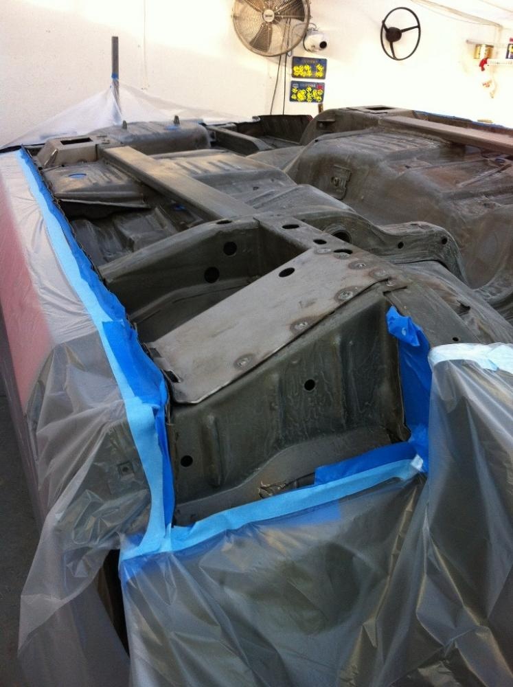

with all that is going on I got the torque boxes welded in. got to prime and paint. I haven't decided to undercoat the hole thing or just part of it. Sorry about the pictures I used my phone.
Jim

not to be a ball buster but are you sure those front ones are installed int he correct location??
i thought they belonged further forward..
http://www.forabodiesonly.com/mopar/showthread.php?t=211461&highlight=frame+connectors
attachment.php
attachment.php
boy did I make a fool of myself or what? welded the front boxes in wrong..... I should have look first. :wack::banghead::sign3::eek:ops::violent1::banghead::banghead::banghead::banghead:
I do feel so stupid!!!!!!
Well, you are not making a numbers matching restoration here(ya think?), and the purpose of the brackets are to stiffen the frame rails.
I think you accomplished that, just at the crossmember area. Should be fine.

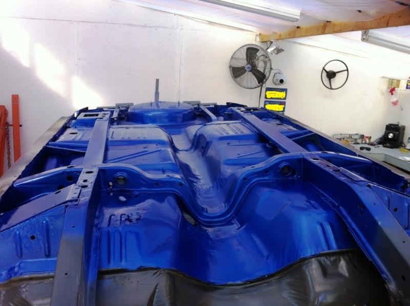

It is orange for the second time.....tomorrow it will be all black. LOL I think if I didn't go the convertible route I would be driving it by now. Oh well it is getting closer. Next I will get the inside cleaned up and painted.
Jim :colors:

I managed to get the undercoating sprayed. I looked at it with a light to see it I missed any spots, well the camera seamed to find some. I guess there will be touch up spots. :eek:ops:
Jim
