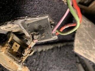

All,
My 1973 Dart has a problem with blowing the #4 fuse. The car is basically a garage queen and has a very good wiring harness with all lighting previously in the car working. During a rare 300 mile round trip I discovered that I had no lights in the dash cluster or rear tails. Upon return I found a blown #4 fuse. Per the Serv Manual this is the fuse for these lights. Swapped in a new fuse and it immedaitely blew w/o any switching on of the lights. I have not been able so far to find the issue.

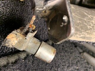

I inspected the taillights and cleaned and greased everything and no go. I unhooked the rear harness from the main connector and no go. I dropped the fuse box and inspceted it with no visual defects. I removed the working dimmer switch and found this. The switch was still working as I had tried the dimmer before disassembly. I'm going to unplug the parking lights and slap in another fuse to see if they/it is shorted and causing the fuse to blow.
From here I'm not sure where to go. For sure the dimmer and plastic body needs replacement, I suppose that the one cooked lead could be marginal and need insp and maybe replacement too, I see where this is not unusual for these to corrode and fail or have a huge current draw for some reason.
Who has had this issue and what was the cause of # 4 fuse cooking off? Where should I go from here?

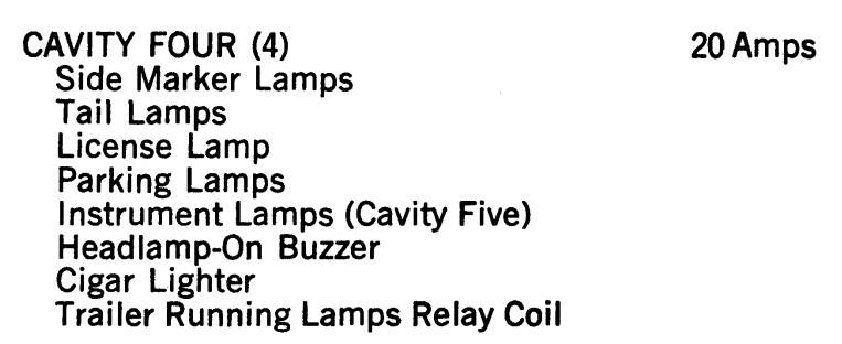

OP did you look it up--- what all does that fuse supply? I'll assure you it does NOT supply the dimmer because the headlamps get direct power from the ammeter circuit. the light switch has TWO power sources.
One HUGE flag, for me, is that fuse no4 also operates the LIGHTER
Could also be a short in the cluster lighting dimmer circuit, HOW THAT works. Fuse 4 feeds power to B2 on the light switch, which powers tail/ park/ and the dimmer control for the cluster lamps. After power goes through the dash dimmer control, it LEAVES the HL switch on TAN and goes down TO the INST fuse, normally on the end of the panel.Through that fuse and out to all dimmer controlled dash lighting on ORANGE lighting. So if the INST fuse is too large, it may not blow, or the short may be in the dimmer control or that TAN wire
