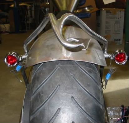

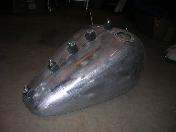

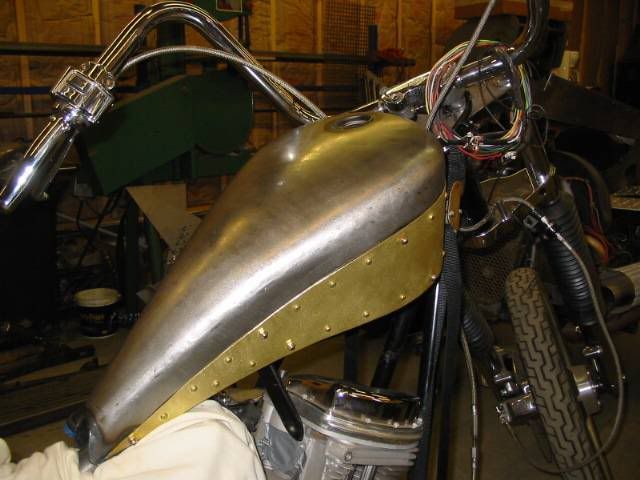

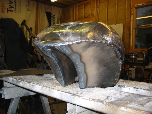

Previous works:

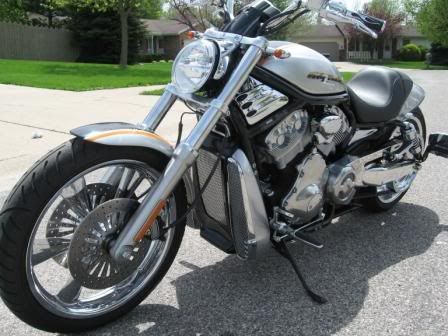

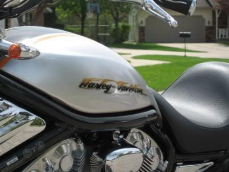

That's all customer stuff, this is my bike:
