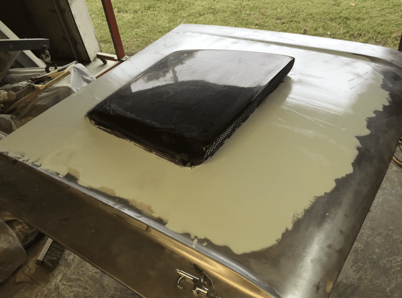

Looking for what kind of bonding material to use to bond a scoop to my trucks hood.
It's called panel bond, 2 part adhesive and it is expensive.Bet 3M has something, I would call them.
If it works is all that matters. I have had scoops bust at rivets and bolts as they get old and become brittle.It's called panel bond, 2 part adhesive and it is expensive.
There is a problem here. There are two types of resin and they are not compatible. Epoxy and Polyester. Epoxy will not adhere properly to polyester and vice versa. If you sand a part of the scoop and it has a floral smell it is polyester and you must use polyester resin. If it has no smell it is epoxy and you must use epoxy resin. It may "work" but it will almost surely crack or fail otherwise.soak them in catylized fiberglass resin and apply them to the hood in the area that you traced out for the scoop. 2 layers of the fiberglass matting. Now brush fiberglass resin to the mounting face of the hood scoop and set that onto the Fiberglass matting and let it dry overnight. Follow up with body shop procedures for filling and shaping to contour, prime and paint. Can put some weights on the scoops to hold them down while they are curing the bond. Not drilling holes in the hood for mounting is a good thing. If things would ever change you can strip them off with paint stripper without destroying your hood in the process. ☆☆☆☆☆
Guys I know say Crestabond but nobody has used it so not a actual piece to see. Thinking rivets and some bonding agent.
Well I guess I broke all the rules after reading this thread! My hood is cut out and my scoop was riveted on when I set it in fiberglass putty, but I did grind off the rivet heads after it had set up. I laid fiberglass cloth over the top, then body filler to level everything out. I did this in September 2015 and it still looks good today. Worth noting that I did brace up the edges of the hood after cutting out the opening. I also used the metal I cut out of the hood to brace up the hood scoop and incorporated a support brace in the center of the scoop to cut down on the flexing from the wind.
