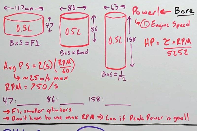

Based on the video and my calculations, the Mopar small block RPM potential would be 9,000 RPM.
Haaaaaaaaaa Haaaaaaaaa haaaaaa haaaaaa.
It's doable, but with the 59 degree LBA and the screwed up oil timing you have a very narrow widow to make it live. By narrow I mean >< and that's about twice as wide as it should be.
I've never owned an engine with an 86mm bore or stroke and don't plan on it.
Too many maybes, likelys and abouts in his schpiel for me to take him seriously.
video-bore-vs-stroke-which-one-is-worth-more-power-2020-01-10_18-40-52_344509-960x640.jpg
Wait, what? 3.58 stroke is 90.9mm, ( 1inch being 25.4mm)
(90.9x2)x(7200/60)= 21816m/s
WTH does that mean?
I think they forgot a conversion factor to change mm to meters: so divide by 1000=21.8m/s badaboom. I guess that's why my6014 mm engine, has survived this long,lol, I'm only at 87% yet..........lol.
86mm is 3.386 inches, so a lil more than the standard 3.315 SBM stroke; but not quite as much as a 3.58 from a 360..
But even the 273 has a bigger bore at 3.63or ~92mm
But lessee, to be square a 3.58 stroke 273 is almost there,lol. That's 296 cubes
And the 408 starts out life as a 4x4
Jus ruminating...
