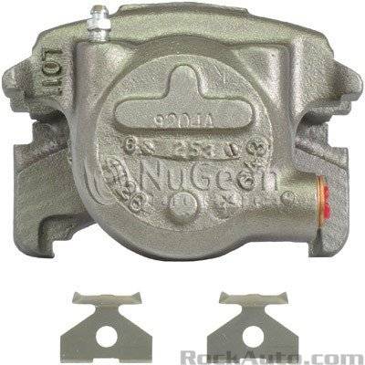

If I swap the calipers the nipple will be on the bottom and the brake hose (supply hose) will be beneath the piston and nipple this is correct?
Those are A body 73-76 ish calipers. If you had later 82-85 ish diplomat calipers it would take care of that. I would still swap them side to side, but bleed them first off the rotor by putting a block of wood in between the pads to act as a rotor until they are bled, them put them on the car... does that make sense.
this is a later diplomat caliper. If you can visualize this in place of the one you photographed you can see that with the right hose attached to it, oriented away from the shock you’ll have no interference, and less overall movement of the hose.

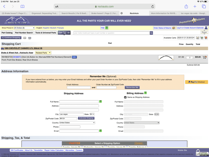

Yea 69 camaro hoses may have worked better but I ordered a set (these ones) that I saw recommended on FABO and only after the fact saw people posting about camaro hoses.
sometimes don’t try to make something wrong work just because it’s already been bought/paid for. Brakes are a serious thing. Who ever recommended them for this application was flat out wrong. The right hoses are cheap.
the right ones are $30 shipped to your door.
Actually my 76+ 2.75 diameter piston calipers are the same as these ones.
You could use either of your calipers (black or gold but swap them side to side) if you get the right hoses and bleed them off the car with the bleeder pointing up then bolt caliper in place. It’s a pain, but that can work.

Your '73-'79 calipers and A-body hoses are designed to be installed facing the front of the vehicle. Mounting them toward the rear results in funky hose routing.
'80 and newer calipers and '69 Camaro hoses yield a much cleaner installation.
