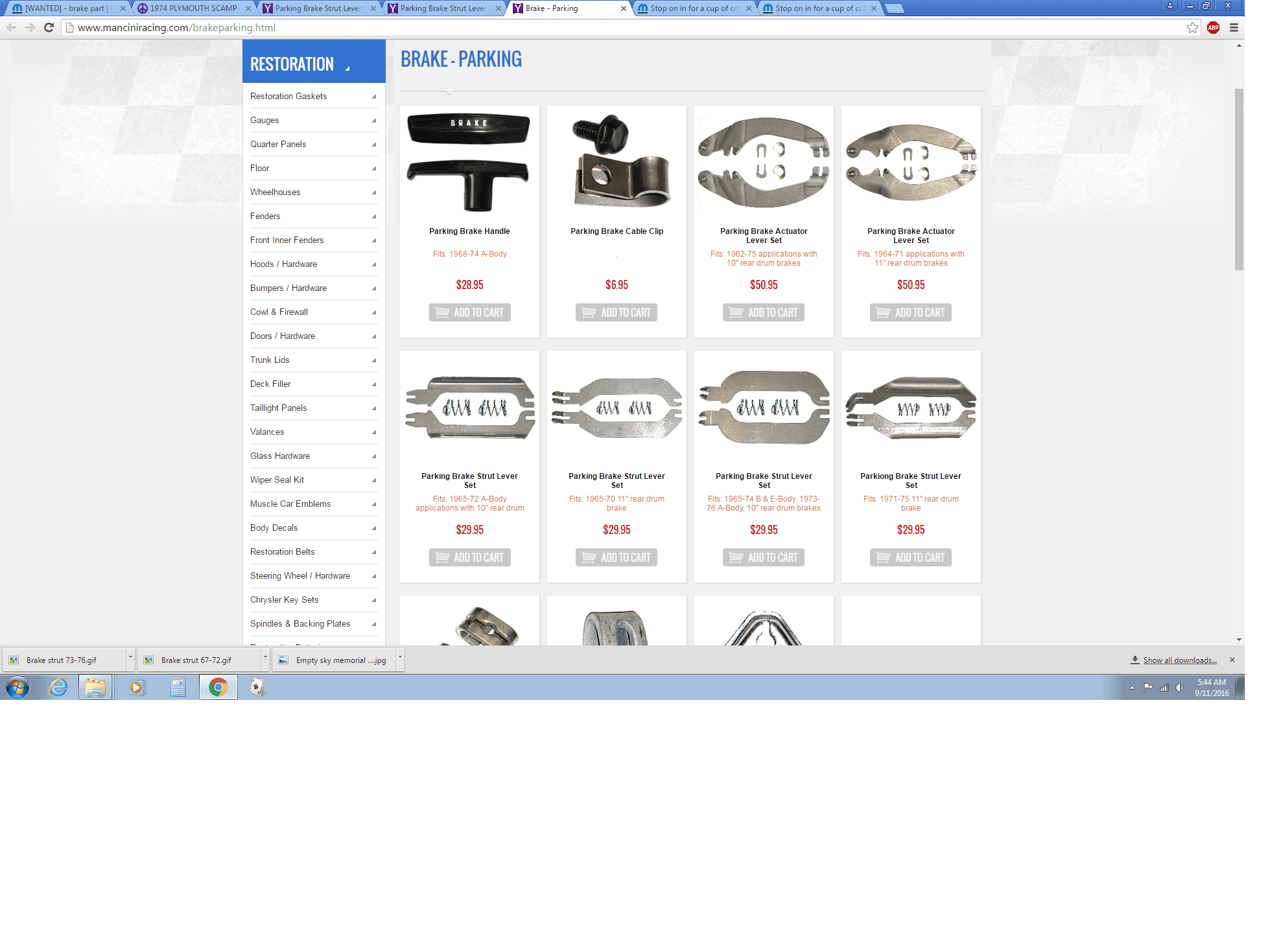

looking for parking break actuator levers left and right, for a body 8 3/4 small bolt 4x5 10x13/4 drums, these are the ones that go in the between brake shoes and packing plate. Thanks
I am pretty sure I have a set off of a 8 1/4 I think they are the same not 100% on it though.
I am reading the mancini site as all with 10" brakes on the leavers? School me sensi!
Parking Brake Actuator Lever Set

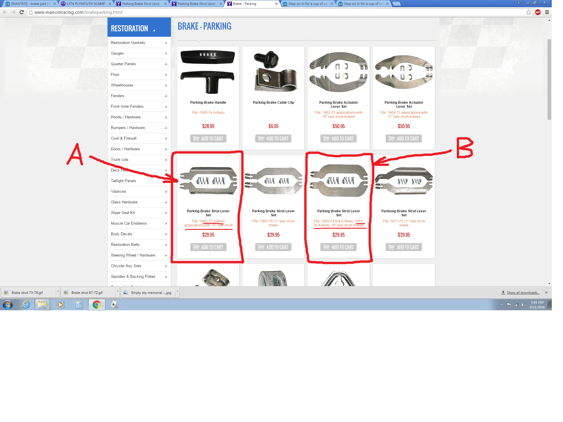

The 8 3/4 axle brakes are only 1 3/4" wide, so they need to bent them up so they don't hit the axle flange...
The 8 1/4 axle brakes I believe are 2 1/2" wide like the B & E body brakes so the strut levers can fit without flaring the ends up to keep from hitting the axle flange...
Here is the 8 3/4" style:

Oh, I thought he needed the strut that goes in between the shoes.... Not the levers that go from the shoe to the cable... The backing plate wording confused me...
I didn't understand his description correctly...
Yes, the levers that you showed are all the same for the same diameter....
