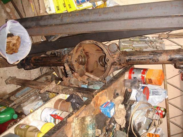

on Wednesday and Friday I worked on rear axle. I'm trying work on suspensions. This way, I can weld the floor panels and put my car on four wheels.
Firts picture... I disassembled rear axle and cleaned it.. I had to bought some bearings.. I bought first class bearings.. some Chinese bearings where much cheaper but low quality.. I don't trust it.
pay attention on first picture.. there are some metal bar with the rear axle.. they will be my subframe connectors. I need to make some new cuts on it and weld.
I also disassemble rear breaks. Have to paint and put new parts. They are in good condition and I just need to trade cylinders and brakes material (don't know the name in English).
ps: if someone needs help to disassemble breaks, I do have a set of pictures.. just ask...

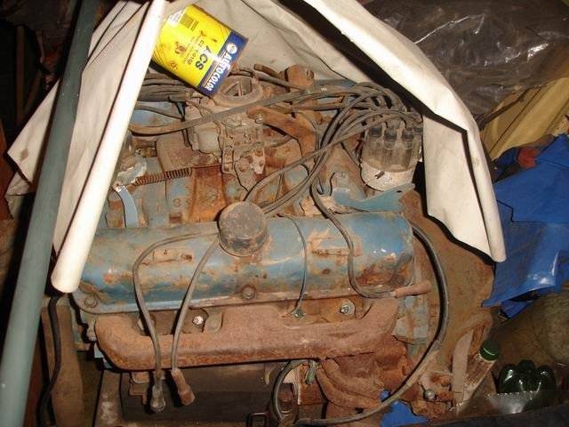

my engine. It is a 318 small block. Have to clean, paint and do some more stuff..
meanwhile I'll use as it as. But I want to make it better. I have a summit intake and a 650cfm spreadbore carb to use. I intend to buy new parts to complement my project... but money.. isn't on my side :(

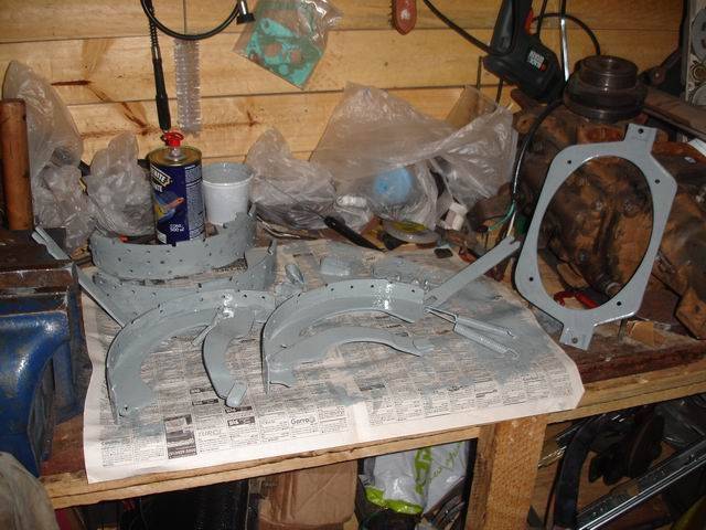

finally it's Friday.. Went to my junk room and painted break parts.
I used light gray. Don't know if will the best option but I think it will be easier to see any oil leak in the future.
The outside parts will be black (or black mixed with a little portion of gray). Rear axle, rear break drums..

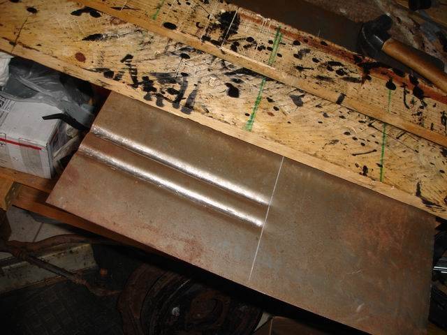

Today I took a few hours to cut a piece o sheet metal and worked on it.
This piece will be the driver side, front floor piece that I don't have in my dart.
by the way, happy a 100 posts!
