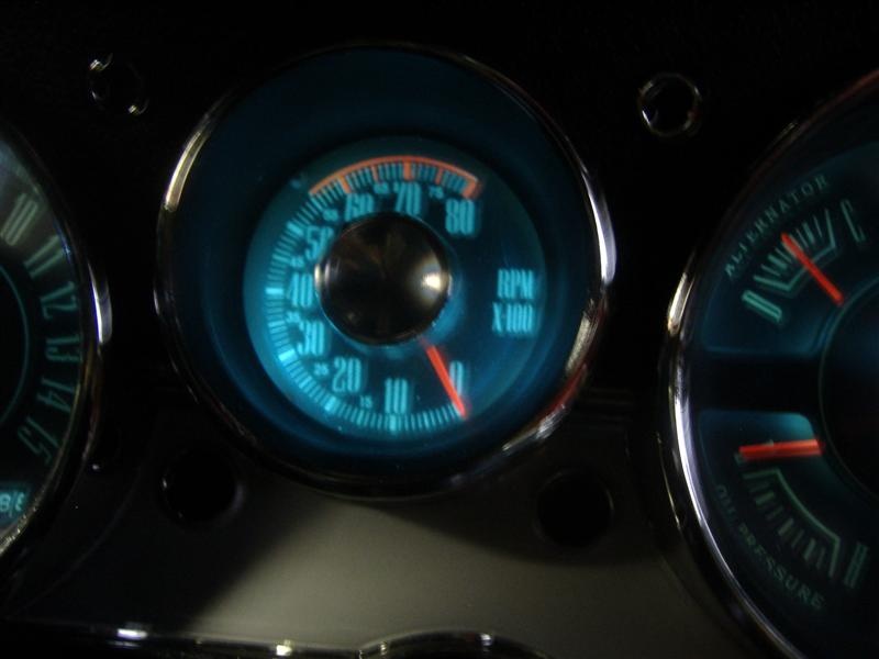

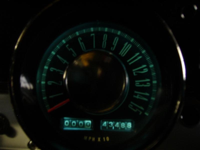

Update on dash light brightness
Took the cluster back out this p.m. and installed the LED's
Let me tell you........these are great!
I used (4) of the WLED-WHP5 from superbrightleds.com
They were cool white and coming thru the blue diffuser made
all the difference in the world in my dash.
I only replaced the instrument lights.
That little project is complete!:thumblef:
So wheres the pictures of before and after to show the people?
Just took these......not dark in the garage
With LED's
This is way better than what I had
