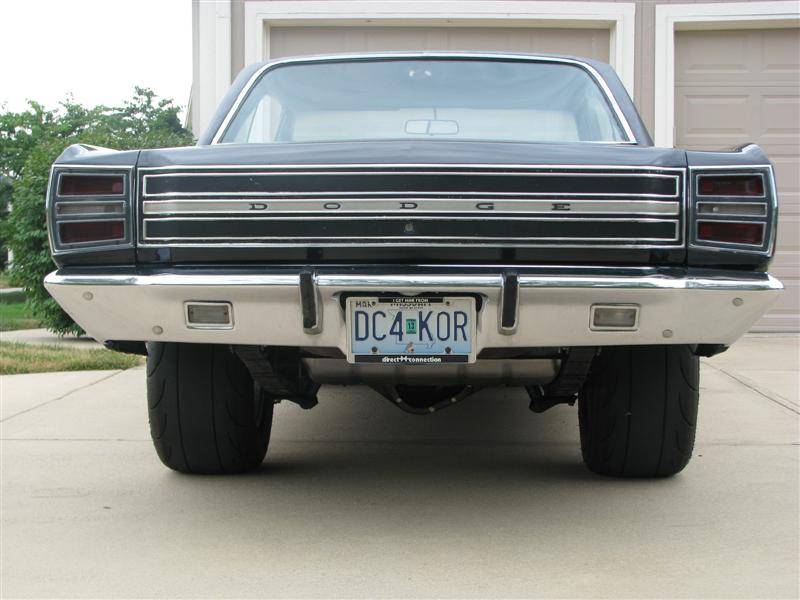

I usually just leave them with the small gap. The car doesn't pull to either side, so no need to preload one side versus the other. I'll know more when I try the stickier tires. I posted these pics on the other cal tracs thread.
