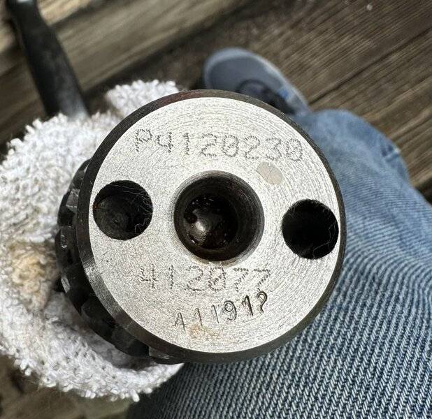

Cam is out. Looks like a purple shaft 284 duration. I can’t see any abnormal wear on the cam or lifters. I guess my measurements from a few days ago were off a little. Still too big of a cam for smog motor I would think.
Measure the lift of the potentially worn lobe with a caliper, see what you get.
Biggest measurement - smallest measurement
Be interesting to see what the installed height/spring/rotator situation is.
.323 X 1.5 for rockers = 484
Measure every lobe and see if any are worn.
