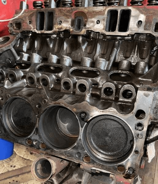

I was told by the seller that the motor in the truck had only a few hundred miles on a fresh rebuild. I was skeptical, but I have not found anything to dispute the claim. Pistons are 0.030 over. There is no ridge at the top of the bores other than a few places I can feel the slightest amount of carbon. Zero sludge anywhere.
Look at the pictures of the CC. What can you guys tell me about the tuning job?

One sign that’s always a red flag for me is…….when the head/deck surfaces have been subjected to some “cookie dusting”
It wouldn’t surprise me if the extent of the cylinder head “rebuilding” consisted of much more than cleaning, valve lapping, new seals.
But that will be revealed after they’re torn down.

Interesting that the casting number is missing a digit.
Should be 3418915.
From that pic, it appears the heads were actually resurfaced.
