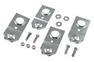

Lol, Don't forget a set of these (picture below) when you do the above.........:blob:

I raised my old '74 dart with shackles. There were 3 holes for heights, I used the 1st hole and it raised it only about 1 inch. I cut the remainder of the shackles off. I had these on my dart for about 8 years or so, never had a problem. For 15 bucks, it did exactly what I wanted and caused no issues. I wouldn't recommend doing like the picture above... LOL
