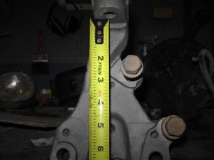

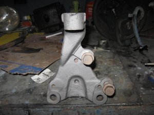

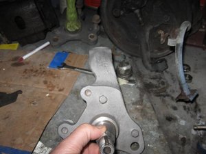

Can any on tell me if theses spindles are ok to use for a disc conversion on a 67 dart. Can only get a partial number off the spindle itself 34026(XX) last diget poss a 8they came with 11" rotors and the slide type caliper.

Yes you can. You will need the upper control arms for that spindle (large ball joint). Your 67 Dart has small upper ball joints. You will need the lower ball joint to fit the spindle for disc brakes also. Check out the size of the lower holes in the disc brake spindle compared to the 67 drum brake spindle.
Looks like late model FMJ knuckles. Those are the lightweight version and are the best ones to use for disc conversions.
