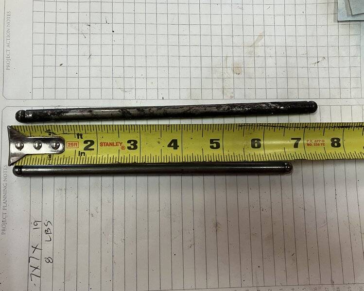

First are these pushrods. I have several used LA hydraulic flat tappet pushrods picked from different 318s and 360s. They are the ball/ ball design and seem to measure right near 7 1/2”.
I just found a clean set of ball/ball pushrods that measure 6 3/4”.
Is it possible that the shorter pushrods are for the roller cam 318/360 ? A friend gave me stuff years ago when he went to 1.6 adjustable rocker arms and I wonder if these 6 3/4” pushrods are just what I needed for a build I’m planning.

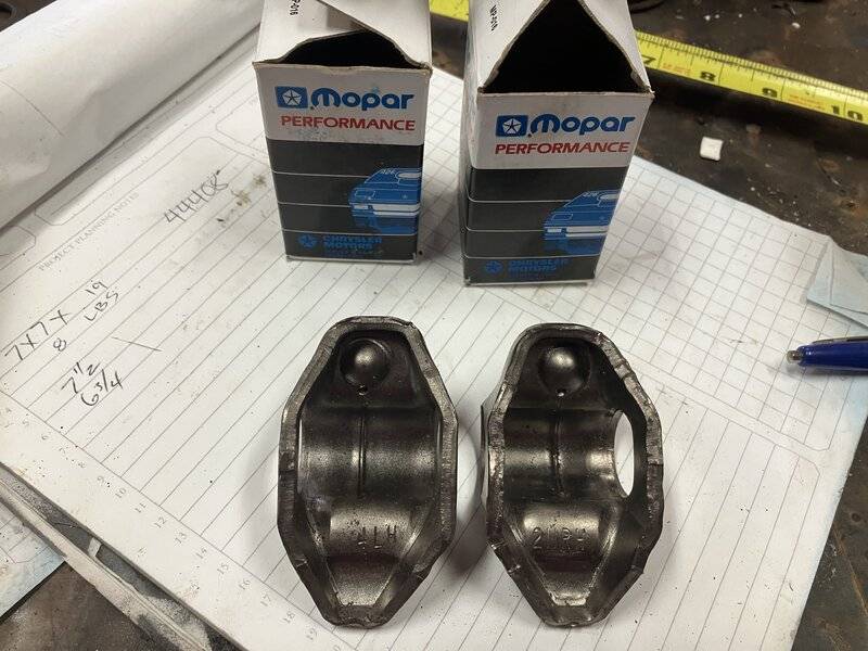

Secondly, I have a box of these:
It is self explanatory that they are replacement rocker arms but I don’t know how to tell the difference between LA versions and the B/RB.
I’d appreciate any help you can give.
Thanks!
If you Google the part numbers you will see the rockers are small block and the push rods are for roller lifter engines
