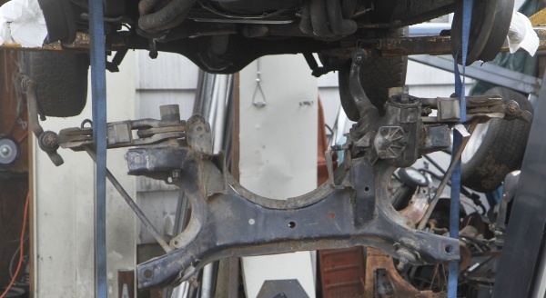

I'll tell you guys WHUT. At my age and condition, I would not be able to do ANYTHING without my hoist. And it has been useful for other McGyver projects, like using the lift arms to hoist parts of my Farmall final drives for brake replacements, etc, and a simple, homemade platform to accomodate the garden tractor.
Dropping an engine out the bottom of a van
Junking a car (then lowered it to trailer)
Test fired a used engine
Swapping a K member
