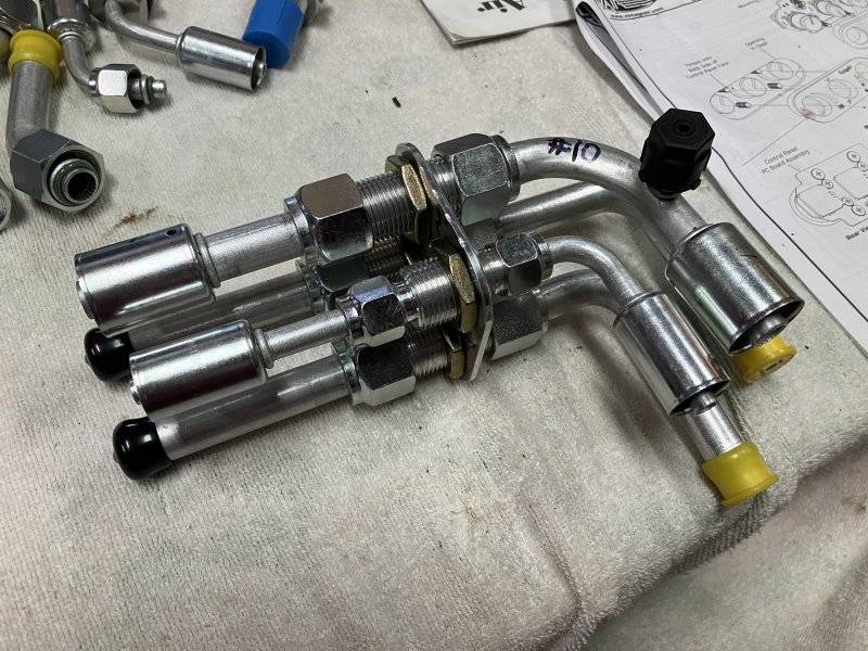

We've discussed their perfect fit system as being anything but. I did get the heater core tubes bent to fit and the large AC tube moved so it will fit the blower motor hole in the firewall (no pics of that). I will need to make a new cover.
A while back I grabbed the condenser and tried to fit it. The supplied brackets were obviously not going to work so I looked at the instructions. They said to clamp the condenser brackets in place with the radiator brackets. Um, NO. So, today I made up four brackets and it's solid.

The brackets I made move the condenser forward by about 1/2" The radiator (Cold Case) should wind up about an inch behind it. The radiator will go back in soon.
