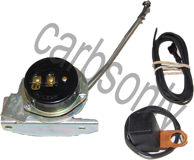

Are you talking about the generic kit, like this one from carbsonly.com?
I'd really like a carb with an integrated choke, but since the BBD is already on it, I'm interested in what I can do with it.
This generic kit in the picture is a little more complicated than I want. You have to get the coil positioned just right, and then there's the sensor that has to be hanging on the engine, and the wires need to be going from the sensor to the actuator... I'd also have to fabricate some type of mount since these are designed to mount on the factory exhaust manifold.
I'd really like something simpler - something I can just put on, and never have to think about the choke again! :)

I had an electronic choke with clifford stuff and when it rained the choke would go off no matter how long you have been driving. After working with it for years I gave and unhooked it no problem a casset case worked fine when cold till it was time to leave.
All you have to do is buy that electric choke you have pictured from carbs only. Make a little arm extender to put on the end of the arm to attach to the carb and then attach the choke puller on one of the holes on the head you use to attach a cherry picker to. The arm extender is because the hole on the head you'll be attaching it to is just a little further away from the carb than the original choke pocket it would normally mount on. Take the little choke thermostat deal and attach it to the other hole on the head. Get the two wires connected like the instructions say and you're ready to go. The thermostat will draw enough heat off the head and next to the headers to activate. All you have to do then is adjust the choke puller by turning the body of it and it'll leave the choke on longer, or pull it off quicker depending on your adjustment.
