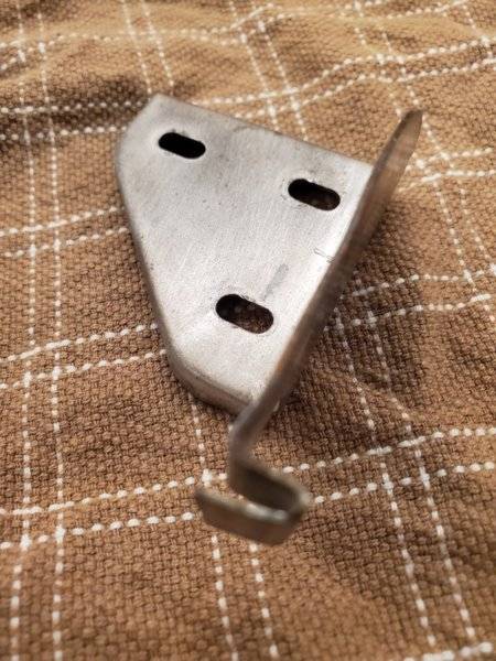

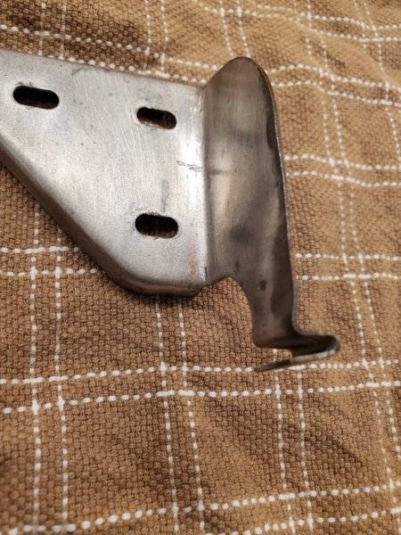

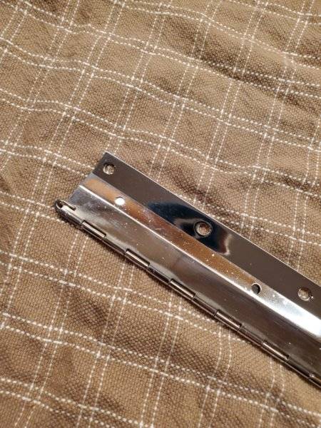

On my 69 Dart, console is wood grain decal with no button, just a lip to pull open. The piano hinge is spring loaded to keep the cover in a closed position. The rear guide (screwed to the underside of the cover) has a round edge that catches a notch in the console base, that holds it open. A little downward pressure and the top pulls closed. (see pics of parts ):

Do you have a pic of the metal notch piece in the console base at the aft end? If you have one that's a spare I would like to buy it from you, if not I am a metal fabricator by trade, could you send me a tracing of it?
BTW I took the later spring that is spring loaded to open, and wound it to be spring loaded closed, so that part is fixed, I also tweaked the door closer to flat by hand.
Matt, I do not have a pic of the piece on the console base, I am not even sure how to describe it. I thought mine just had a notch in the base itself, but I will have to look closer. My car is about 40 minutes away and will see it hopefully by the end of this week.
If you can wait, I will gladly document what is now there and take a few pics.
It's cool. I removed the one tab on the back of mine. It had a folded over end for I am assuming the cars with the latch and spring open console door, so it couldent be over extended open. Theres marks on it where the door tab scrapes against it. I can use that as a guide as to where to pop a rectangular hole or something. Will make a new one out of .032" stainless steel sheet with a hold open hole at work tomorrow. BTW with a little adjusting of the hinge, and tweaking the lid with my hands, I got it really close to perfectly lining up with the front plate.
Also noticed theres 2 holes for rubber bumpers for the door. One at the front, one at the back. Who sells these?
There is just a detent in the console plastic for the metal piece to snap into to hold it up
That's it huh? Well that's something I'm gonna have to get crafty with. That chunk of fiberglass is missing out of mine lol
Yes. Mine just has a large opening in plastic console, not as nice as Rat Rods.
Mine has been setting on top of the console to hold it open. RatRods looks more correct.
