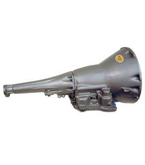

.........and the underside of the transmission tail housing has to have the bolt hole ears cast into it for the bracket. Go Download yourself a shop manual if you don't have one, free, from MyMopar. Find a drawing..............
Down this page, no. MD2540. I didn't look to see if that is the exact correct one
Dodge Dart Parts | Transmission | Automatic Trans | Shift Linkage | Classic Industries
Here. You can just barely see the two bolt eyes hanging down between the main case and the trans mount
