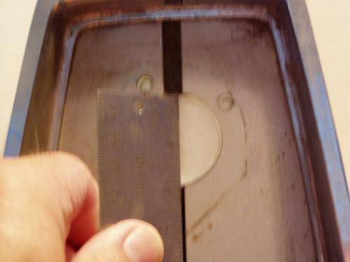

Im about to install my N85 console tack on my new console top. It is a 69 Dart with a 4 speed.
Does anyone have any insight on where it should be mounted, or maybe a measurement or template?
I've seen a few pics, mostly automatics, but its difficult to know the correct angle before I drill through the new top.
Thanks guys
Take cover plate off console, flip it over, and look at the underside. Theres markings where it needs to be drilled.
Here's some measurements I used, courtesy of Jim Lusk...and lastly, a pic of mine installed....
