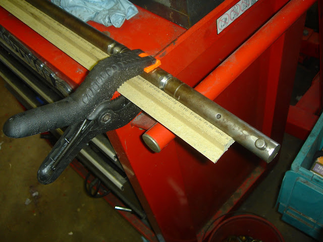

Just push the column in about 2.5 inches...Seriously, a used manual column may be cheaper than that $125 chunk of metal. I just cant see myself buying that adapter..But hey, Im cheap. I hacked 3 inches off a junkyard car and welded it to the end of my auto column...
That is a nice ideal
