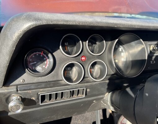

So at this point it’s getting to a point where I feel I can start to tinker on improving things and fine-tuning stuff rather than just getting it to a consistent state. Bearing that in mind my first move was a new tach since my factory one does not work and I figured it would also be beneficial for further tweaking on timing, idle etc.
I grabbed a universal 2.5” tach from the local parts store, it’s a hair too small so I had to mess with it for a while getting a setup together to make it fit the factory hole properly. It still need some fine tuning but functional for now..
So my idle in park sits right around 1000 after the choke has finished backing off. In gear it drops to closer to 500rpm and seemed to have a little miss to it so I think I’m going to bump it up 100-200rpm.
