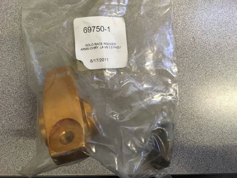

I need to replace a rocker arm and I can not find one. dose any one have a part number for them? the rocker arm had 60-1.50 on them. i believe the adjuster nut was for a push rod with a 5/16th cup on it. engine is a 360 .040 over with 340x heads.

I don't think the gold rockers have been available new for some time? You might try asking on the various forums for sale boards or ebay for a single.
From that picture, I bet that rocker could be repaired. If you can't get a local shop to do it, try Rocker Arms Unlimited. Rocker Arms Unlimited
From the part number the one member posted above nobody had them I didnt check cranes site but another member messaged me and he said he has a brand new one he could sell

The MP rockers are Crane. I did see a single rocker for sale here at FABO. I can’t remember much beyond that. IIRC, $35 it is.
Good luck with the search.
