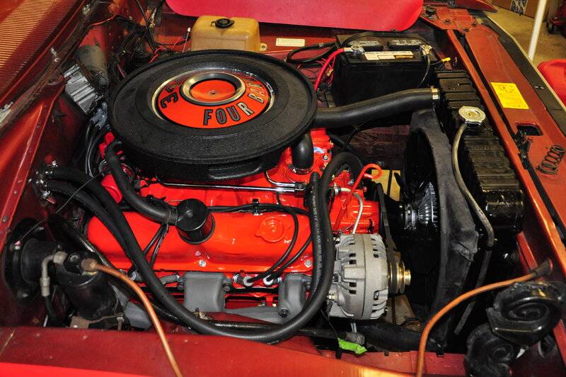

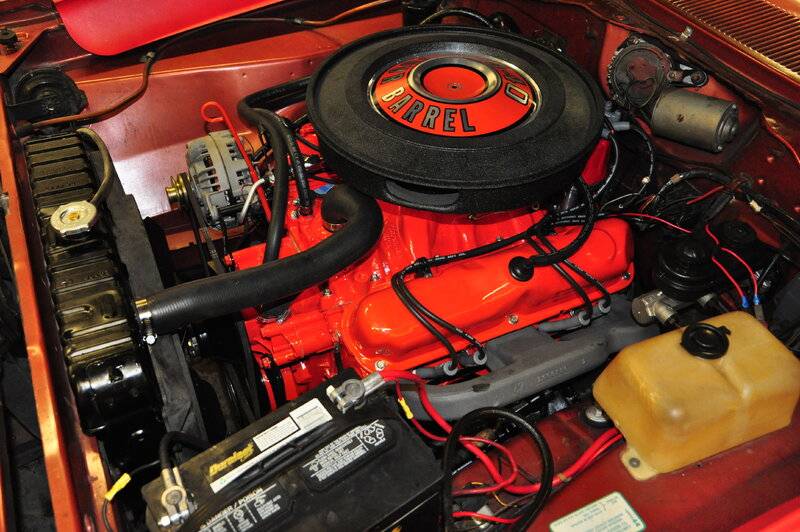

I’ve not had the chance to run my Barracuda for long, but I’m seeing oil build up on the manifold in front of the carburettor, looking in the filter I’m not seeing any signs off oil so at this stage I am thinking dipstick or from the valves on the valve covers.
The previous owner had removed the breather from one cover and instead there are 2 PCV valves neither of which is connected to the vacuum port on the carb, so I’m guessing not a lot of cross ventilation is going on and potentially any build up of vapour etc isn’t able to escape through them.
Even if this isn’t contributing to the leakage I’m thinking I should try to set up a functioning ventilation system. Would anyone have any thoughts on PCV valves to use? The air cleaner housing has a pressed blank for drilling out to insert a fitting to run to the breather, or I could use a breather with a built in filter but I have read they can be problematic if not baffled.
Sorry should addd: 318 with a Holley 4BBL and Street dominator manifold.

Your oil leak is probably bad valve cover gaskets. Cork sucks, especially if over tightened. Look for rubber gaskets with metal in them.

Open breather on one side is incorrect. The valve cover breather for the PCV system should be a closed type with a hose nipple that gets a hose routed from the breather to the bottom of the air cleaner. Then you will have a complete PCV system, instead of gettin that "buildup" all over your valve cover from an incorrect open breather. You need a complete PCV system, not incomplete.
Something like this for the under side of your air cleaner:

Something like this for your valve cover:

Thank you, just before I saw you’d posted I found somewhere here selling the adaptor to attach to the air cleaner and ordered the breather with inlet from Year One this afternoon, so yep fully closed.

I had heard that’s why you need a baffle fitted inside the valve cover with an open breather to help stop blowback.
baffle is so you don't suck raw splashing oil only vapor ,and oil don't splash out the breather
that build up on your manifold is probably oil wicking up thru the manifold bolts or a bad valve cover gasket.
anything else would oil down half the engine bay to get that much collected in one area.
One reason PCVs get disconnected is because a bigger cam is installed in the engine, & these have less vacuum at idle. Not enough vac to pull in the pintle inside the PCV.....

I think in a way i am currently running an unintentional road draft tube, just it's feeding into the engine bay!
they look like a stock valve cover. start witht he proper gromets for them..
use a stock pcv valve plumbed to the carb.
as for the breather there are many ways to go.
