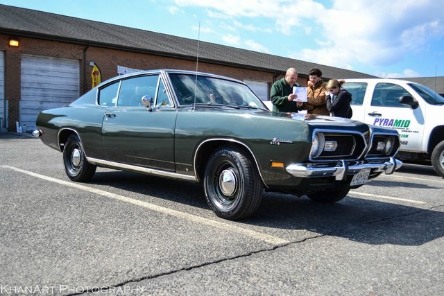

Dads Barracuda
Looks awesome!! Love the green.
Oh, it's more fun if you ask the bride to help you "work out the wrinkles" LOL
Cool car. Color looks like GG1 which is a '68 color. That is what color my car is painted. 360 engine is a great choice, longer stroke much better then a 340.
Just a little heat and some TLC and the wrinkles will be gone! I'm going with the stock sport wheels too, Bill. Can you tell me the tire size you used? Looks great. BTW the paint is a newer Plymouth color the previous owner told me, just a little bluer green.
