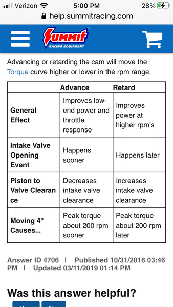

There is probably some truth to this, but on the other hand, there are times when you might deliberately want to install the cam with different amounts of advance (using an offset key). The only way to do this is by degreeing. Some people seem to just want the lopey idle and don't care about performance, for example...

Had a .528 mp cam and JP performance billet timing set be set 8 degrees retarded to be 2 advanced...i later set it to 5 retard for 5 adv where it ran real good.

myself I'd probably retard it. but that's me
