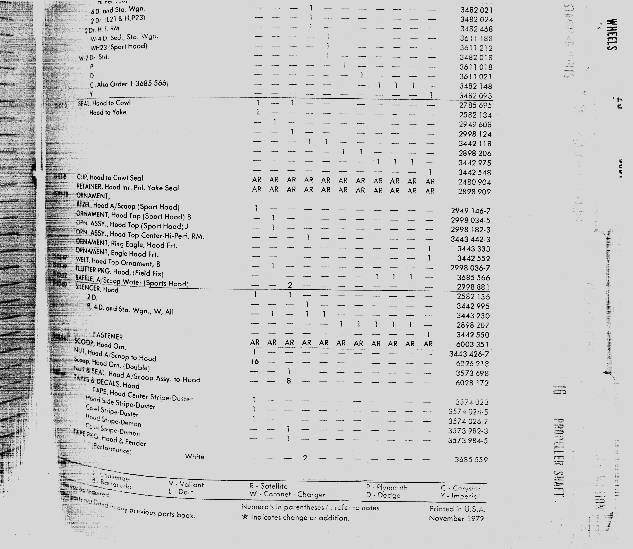

ok i had a chance as promised to swing by my local dodge dealership. they have been in business along time and have alot of old books. i asked the parts guy if he could help me. he went and brought back both a 73 and a 72 parts book out of the back. we then looked up the parts. the bad is there is / was no picture of the parts in question. the good is both books listed the very part w/ numbers that matched for both years. the guys in the back both said that they knew what i was looking for, and could remember seeing and selling the parts over the years. anyway i then asked him if there was anyway to make a copy of the page showing the part description and number. it wasn't easy getting that big book to copy on the copier, so the copy isn't the best. you can read it though about midway down in the third column. it says " baffle a/scoop water (sports hood). part#2998881. it lists 2 being 1 for each hole. the third column is dart/demon. if you look down further in the same column near the bottom you can see the stripes listed and the scoop and scoop nuts to secure it on. the book is dated november 1972 in the right corner. now if the holes weren't being put in then why would they list the water baffels for it in the parts book for 72 demon and 73 dartsport? i still haven't been able to locate the article for this but i am still looking.....hope this helps shed some light.

7Demon2,
Thanks for checking on this information. Your local Dodge dealer is certainly more customer-oriented than the one in my area; such a request at my dealer would have been met with a snide laugh and a not-so-nice "get lost, old timer, we don't stock parts for those cars anymore!"
Anyway, back to what you found out. The fact that the 72 parts book lists the "baffle a/scoop water" (I guess that somehow references the fresh air hole gaskets) as being available for a 1972 Demon is not that surprising. I think we all agree that the snorkel hood scoop, with accompanying clean air holes, WILL FIT this model (as your photos above demonstrate). For that matter, the same can be said for any 71-74 (and maybe 75-76) Demon/Duster.
What this still does not answer is whether the combination of snorkel scoop, fresh air holes/grommets and hood black-out stripe were ever offered as a standard new vehicle option, from the factory, on the 72 and 73 Demon/Dart Sport A-bodies.
The fact that the parts numbers are listed in a 72 Parts Book is interesting, but IMHO, not definitive. I still think you need a broadcast sheet option code for this entire package before making a firm conclusion. Unfortunately, the "sport hood package" called out in the factory de-coders does not specifically list what is included with this package.

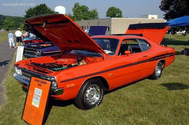

Hi there i'm new at this so please bear with me if some times it takes a little longer to figure this out ( chatting on the form that is)
i just bought a 1972 demon that does not have a hood scoop and from searching the web i came across your conversations and by pure luck i guess i also was looking at a demon that looks very original but before reading all the comments i had not noticed that this original looking car does have as you say the fresh air holes in the hood.
i will try to attache the web page./www.conceptcarz.com/view/photo/124384,11749,0,0/1972-Dodge-Dart-Demon_Photo.aspx
72DemonNewB:
I know the owners of that car. Which car show was this one at? I know they were at one at York Collage, that was only a invitational show thou.
John
I am the owner of a 1973 Dart Sport 340.My hood has no scoop no holes.I have a spare hood which I am mounting the factory snorkle hood scoop.I will be opening up the hood for air induction.I was lucky to pick up the factory scoop at Moparfest this past summer($250.00)I sent the Year-one scoop back that I purchased.The fit was terrible and was made for 71-72 Demon-Dart.Thanks for info. and measurements it will be helpful.
i found the pics on the internet, i was / i'm looking for info as i said i just bought a 72 demon and i'm looking to add a hood scoop so i've been searching for as much info as i can find.
this is mine, i'm actualy picking it up on Friday :)
