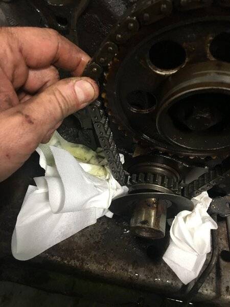

Did 1973 318 V8 have plastic teeth on the timing gears from the factory?

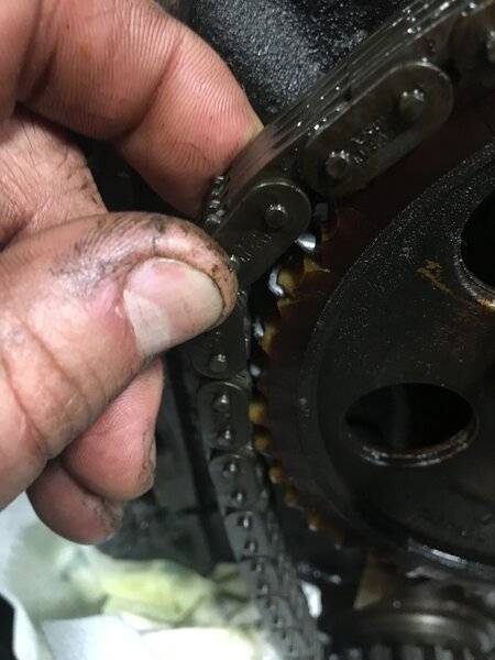

Sure enough. Here’s the 318 in my ‘73 Swinger at around 120k on the clock.
Thanks for your replies and pictures. Mine is a 73 Swinger also with 99K. I am not sure yet if that is a problem but a lot of other plastic mechanical parts on the car already broke.
Mine was not a problem yet. But it could not have been much longer before it was. I dropped the oil pan for a gasket and found all the plastic pieces in the pan. Decided at that time I might as well toss a cam/lifter set in while I was there and swap over to 4 bbl intake.
