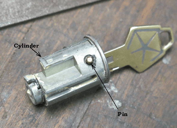

I'll tell you what the problem is. The toggle if that's the right word keeps pulling out of the cylinder with the key if you forget to put your finger on it while taking your key out of the ingniition
The cylinder has what I'd call a retaining pin. If that's failed, might need a new cylinder.

Maybe the pin is stuck and may just need a little penetrating fliud to free it up.

Usually, if the lock cylinder pulls right out of the switch without having to depress the button, the switch housing is usually bad. Just aluminum or pot metal switch housing, so, it wears out easily. '69 uses a unique ignition switch, lock cylinder, and bezel. The $20 one you linked to is not for a '69 model, it's for the '68 and earlier ones.
