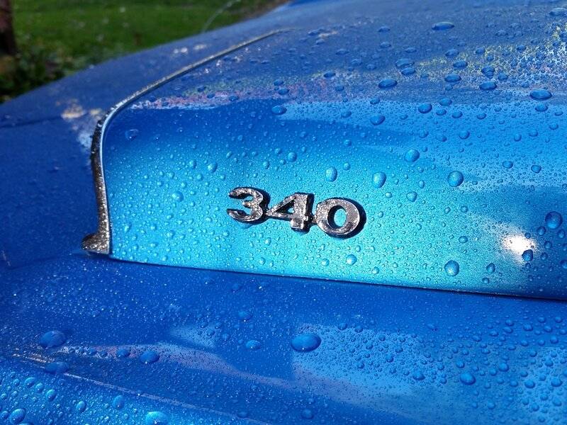

Whether they suck air or not, they are just cool scoops. (dang, I wish I had a 340 under the hood)

I think they're awesome! But yeah, I installed them for looks not because they have any real functional value. They do let some heat out of the engine compartment at low speeds, but I think that's about their maximum functionality.
