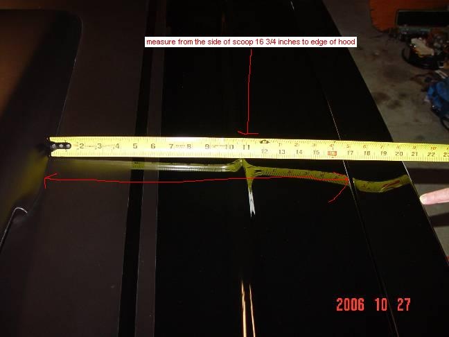

this thread will help answer some common questions reguarding this dual scoop. this is a factory scoop. the measurements are taken from my car. it is a factory scoop installed by ma mopar. first the pictures of what scoop we are talking about....these scoops came on 1972 demons and 73 dart sports only! many people man say differently about their car, but these factory installed scoops were never available for the duster or 74, 75, or 76 dart sport. if it has one, it then it was added later plain and simple. remember these cars were being sold as economy cars so chrysler was toneing down the performance image....

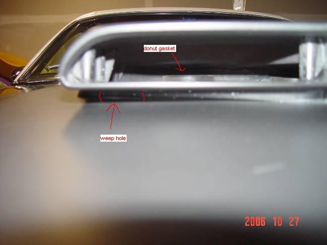

now that we know what type of scoop we are talking about i will proceed. the following pictures will address the questions reguarding water drainage. these scoops as you can see have holes in the hood for air intake. if your car does not have holes like these or in these locations then it is not originaly a car that came with these scoops.. you will see the donut gaskets both from underneath and inside the scoop. you will see the weep holes that allow water to drain out from underneath the scoop as well. there was no other gasket or weather strip involved under these scoops.

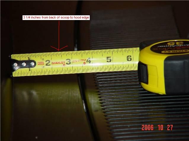

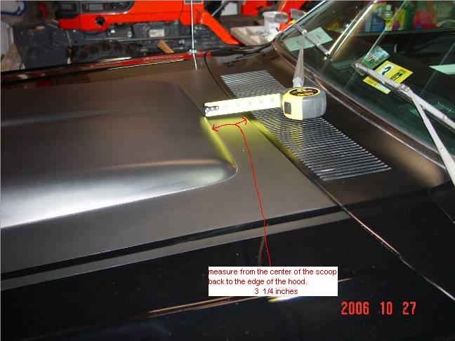

lastly the actual measurements for these scoops. again this is a factory scoop that was installed by ma mopar. hope it helps..
