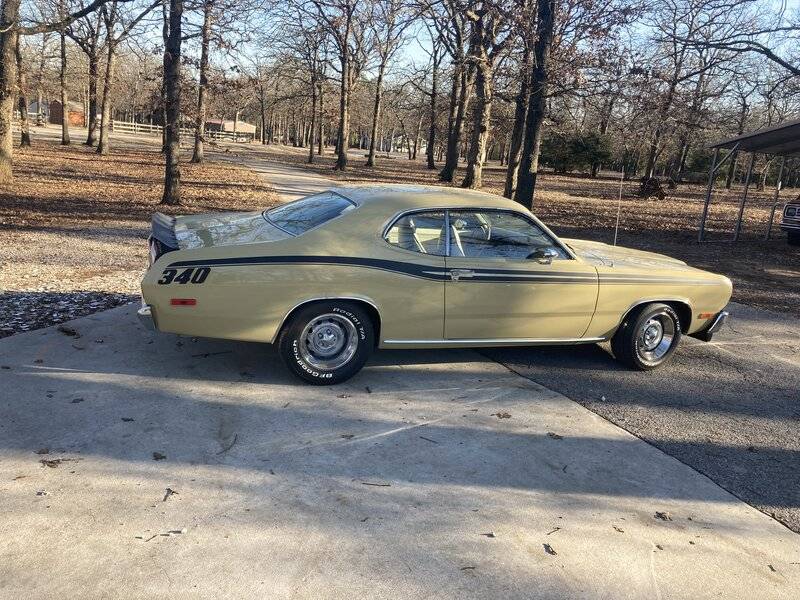

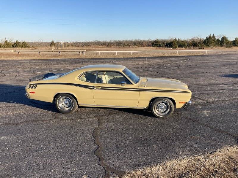

I thought it looked bad with all the bolts. If I would have kept the car I would have fitted it better just setting it on. Then smoothed the outside and made provisions to bolt it on on the under site. You can make them look like they came on the car with some work. I like the second picture above of the charcoal silver car.

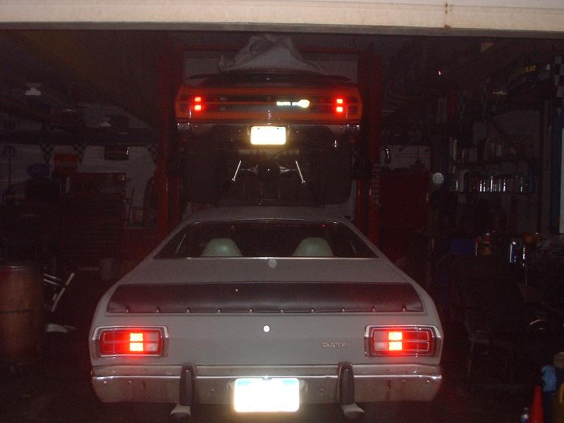

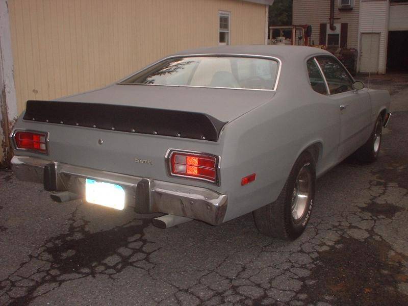

Here is a picture of the one on mine , I didn't like the bolts and how warped it looked. With work they can be made nice.

Mine looked like post #7.
It went on better than I thought it would.
Actually ended up pretty even and centered, and flush.
I used self tapping, 5/16 head fasteners with captive rubber washers.....carefully.
The rubber provides a seal and also gives some leeway when tightening.
