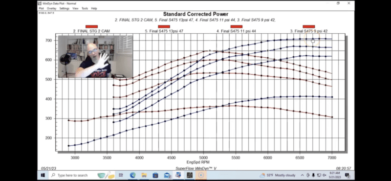

Hp curves from an over cammed, over turbod 4.8 liter. Richard’s words not mine. This is an s475 and look where it makes power. Everything is up after 4500 rpm.

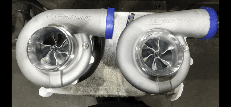

Honorable mention for VS racing turbos. I’ve used a bunch of em and they work really well.

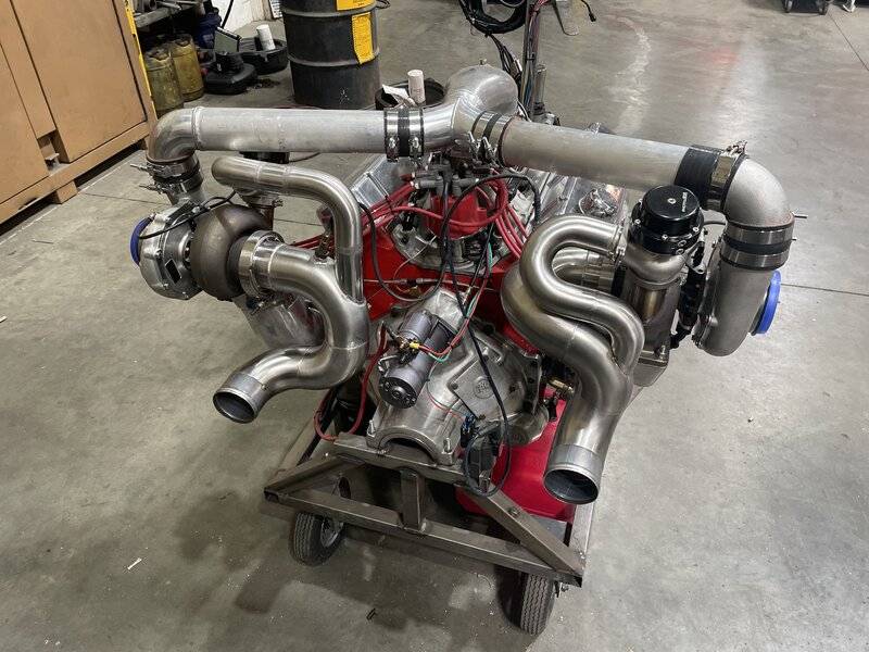

I dealt with Viren (VS racing) when setting up the engine in my boat. He was great to talk to and knows his products well. I run two of his gen 2.5 billet 78/75s and they flat out work.
