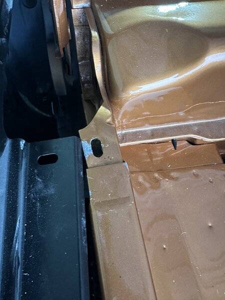

Yup! No reason not to give it a go. Good paint in a can, or go buy a spray gun and practice on some junk first. It's a skill and toolset you'll appreciate having in the future. If you can paint a fence, you can paint an engine bay. It's not hard to DIY the internals. Just be sure to keep track of color codes and product used so the body shop can choose their steps wisely when finishing.
Learning to fit sheetmetal and remove dings and dents is a whole other level, and not something everyone is comfortable learning or doing. Pros know how to get it done and done proper. But all the stuff you don't see from outside is fair game IMO.
Also, strip and repaint or seal and repaint over the copper first. If you don't, normal body flex is likely to crack your paint at some point and eventually you'll be under the hood and seeing copper through cracks, chips, and rub marks. Copper will show super obvious through turquoise, so I wouldn't even entertain only painting after assembly.

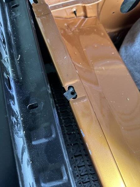

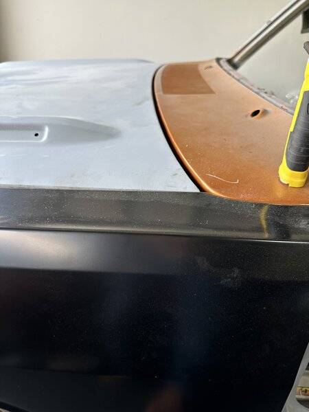

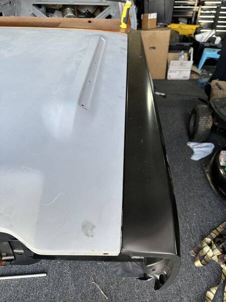

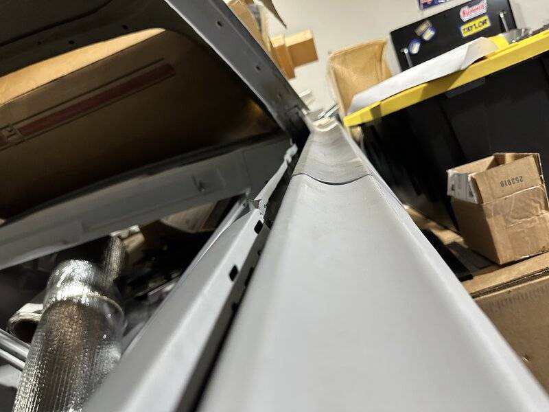

Right now just test fitting body parts.
Don’t mind the garage, it’s a mess and I don’t have tons of room in it for all the extra parts.

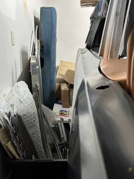

Here’s how much room I had to put the passenger door on.

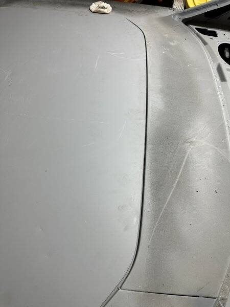

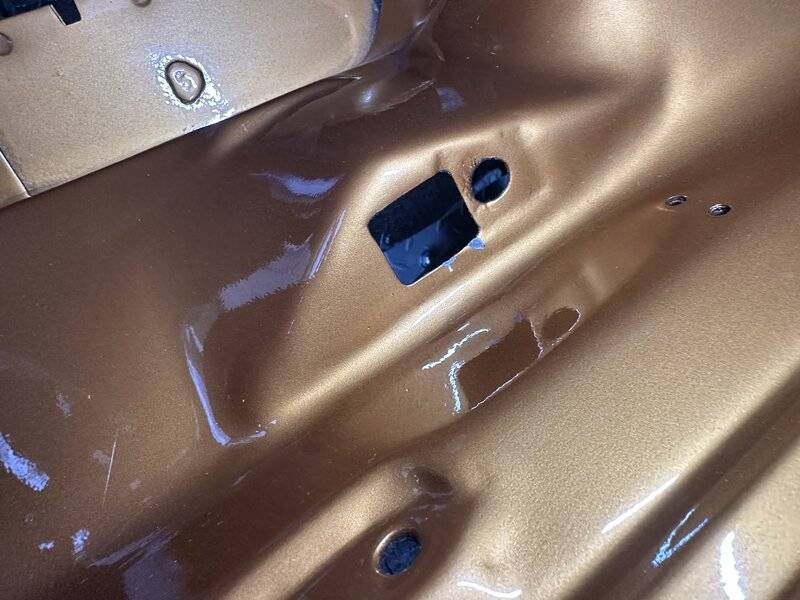

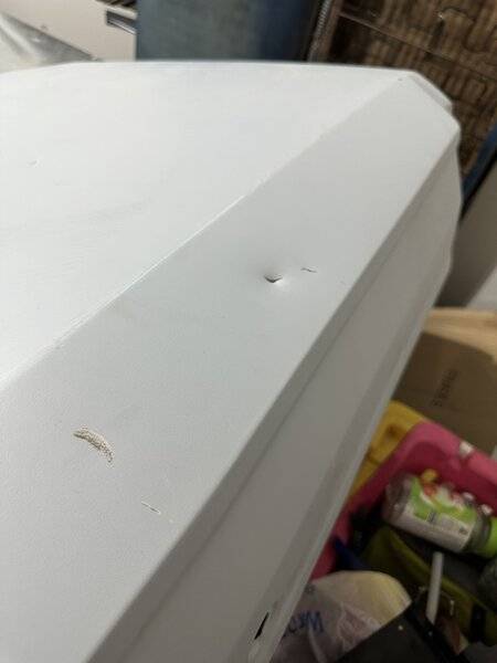

Going to either have to fix my trunk lid or buy a new one, the dent on the lid actually made a hole.
Pull it with a stud gun and weld it. Rust free parts are hard to get. Damage is better then rust.

That ding is worth repairing. It'll be a ton more work fitting a new deck.
Get a scrap fender and a hammer & dolly and practice. Watch a few videos first and get the concept from that. Massaging little guys like that isn't terribly hard. Worst case the body shop will charge you a couple hundred more.
It's not hard to get most of a dent like that out. A body shop could tack the hole shut and finish it off when the time comes.
