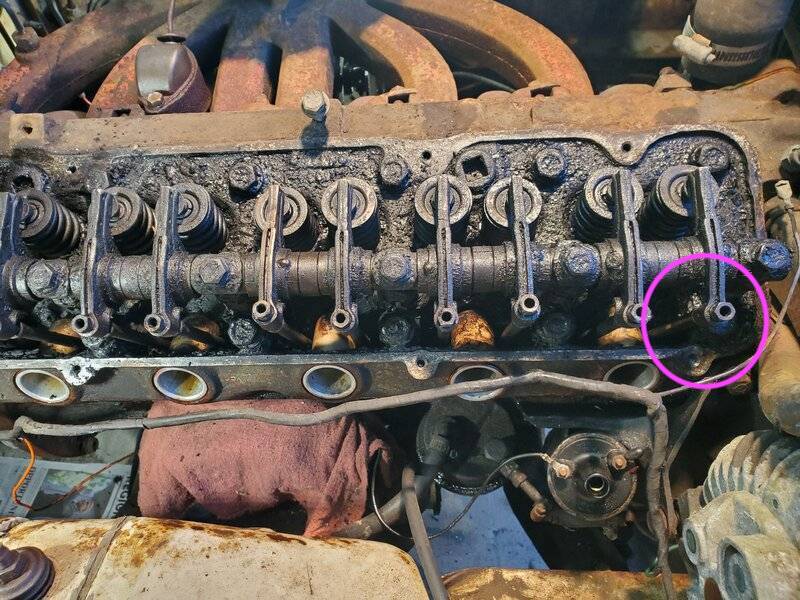

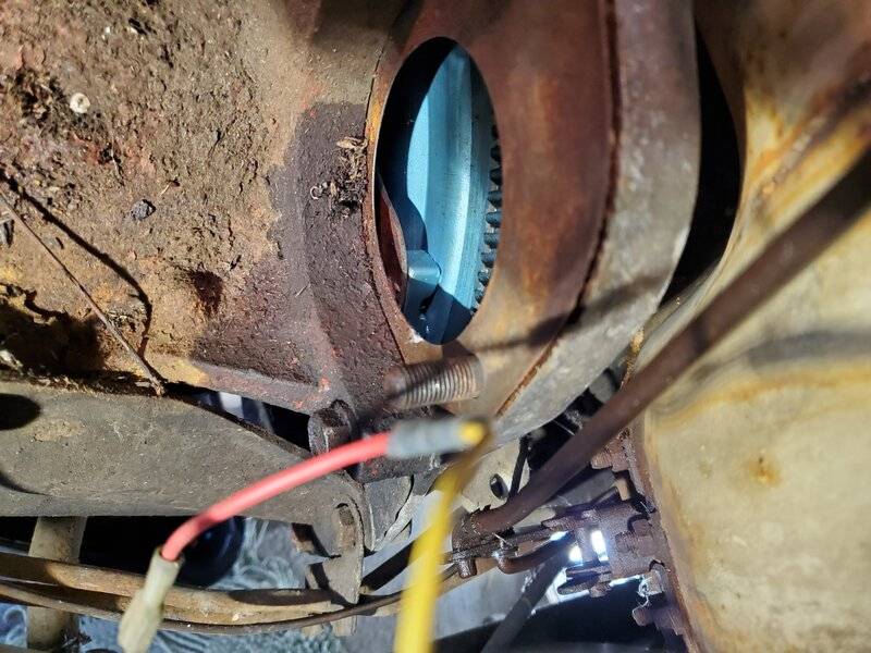

Counterclockwise, binds at the same spot every time and the "clunk" really does seem to be from the back, most likely trans or converter.. SEE PIC: almost looks like this is hitting inside? I am soaking the cables/shift buttons with silicone. I've no idea what gear it might actually be in. Should it rotate backwards if its in gear?
Look at the 6th rocker arm back. The pushrod is out.
It sure looks like it's out in that picture I was talking about.
It's an automatic and not running so doesn't matter what gear it is in, it should spin free both directions. Other than park.
Nevermind. I blew the picture up. What I saw was a head bolt.

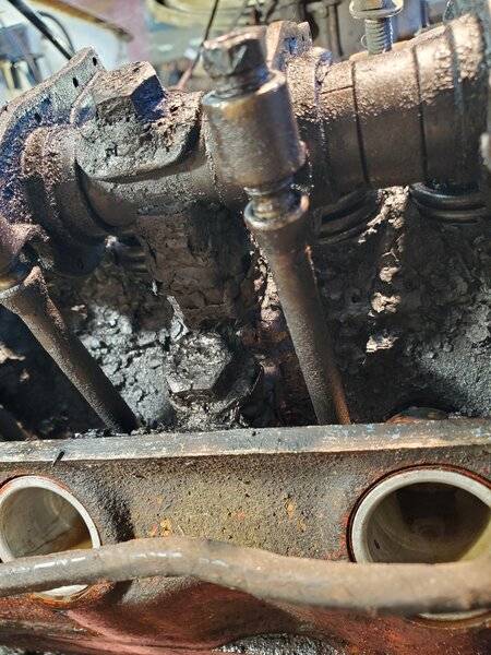

Im looking.. My eye must not be catching it??? Looks like the rest..View attachment 1716314882View attachment 1716314883View attachment 1716314884
In My 36+ year career pro-wrenching, I've seen multiple dozens of broken rods that didn't go through the block, and they'll do exactly this...they lay against the block left bank or rear bank, rotating CW the throw pushes it out of the way & it clinks when it falls back once clear, but turn it CCW & the throw pins it to the block & stops dead...every time....in the same spot.

Looks like the others, que piensa?
Pull the plugs & start at the back, put a length of 3/16" brake tubing in #6 plug hole as 'upright' as poss., then turn the engine CW....does it move, if yes move towards the front 1×1...if You get a no,...well then You KNOW....no Fuke-arown.
Well shoooot... I tried the "hose in the cylinder" test. The front 5 seem to show up and down movement, BUT that last cylinder, in the back, seems to be staying in the same place. The hose, on cylinder rotation, jiggles a little, but that could be a valve moving it. How difficult is a rebuild on these? For all I know the auto trans could be trashed as well.. Body has plenty of rust to fix. At what point is it just not worth dumping money into?
