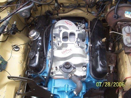

Hers the 318 that my dad did back in 2002 and is the same motor in my avitar (2007) only the manifolds are silver, I dont think the black stuck to well is why he painted them silver. The heads look ok yet but the front of the heads/T cover/oil pan have flacked badly. Basically anything that got oil weepage flacked. She sure looked good that day though. I want it to stay that way this time around.
