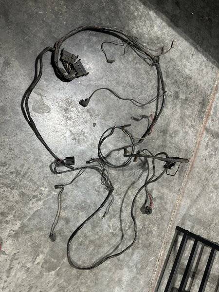

Got a new 69 dart in pieces… needs a wiring harness, but came with a brand new wiring harness.

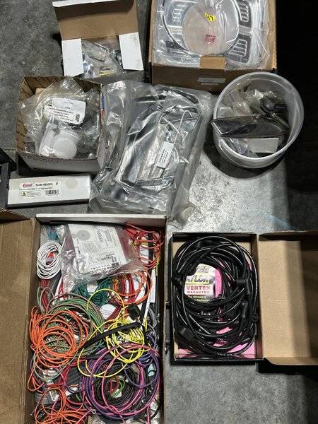

Only problem is the wiring harness it came with is a universal wiring harness, the American Autowire Highway 15 wiring harness. There is also this other stock harness and I am supposed to be getting a couple other stock ones the guy found in his parts stash.

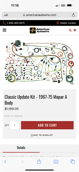

Has anyone used this wiring harness before? Should I try to figure this one out or should I get a new wiring harness specific for the 1969 dart? American autowire makes one for the dart and it’s $1200.

I would take all the harnesses you are given, look them over carefully,
  1. Is the wire stiff and brittle?
  2. Are the wires intact?
  3. Are the wires for a 69?
  4. If most of it is in good shape can you repair the defects?
After you see all that, and the answers are no, yes,yes, yes then repair and install
if the first answer to the first question is no then I would buy a 69 specific OEM style harnes.

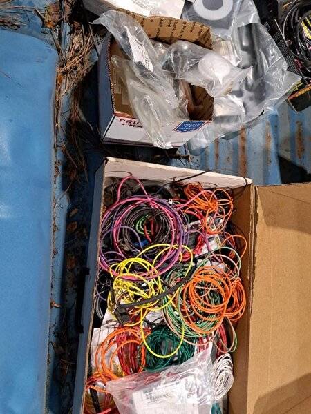

Start with the interior dash harness. If it's correct you can lay it out on plywood, unwrap and replace wires one at a time and rewrap.It seems daunting but 1 wire at a time and you'll get better at it. I dread wiring but in the end I enjoyed doing the modifications on my 68 Hardtop.You probably have all the wires you may need with that kit.(Not my Pic just sole it for an example)
I don’t have a dash harness. Only have the American autowire highway 15 universal kit and one of the engine bay harnesses.
When I read the description on the highway 15 kit it says it has everything needed to wire a car but… I’m sure the electrical gurus would be happy seeing me as little as possible :rofl:

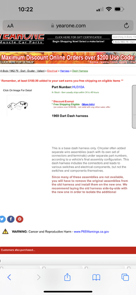

back in town. Looking at the dash harness, I. The description it says “since many of these assemblies are not available you have to remove old assemblies from original harness and reuse them on new harness…” what the hell does that mean? What assemblies or portions of the harness do not come with the dash harness?
Map light, console, ac, defrost. Probably more lol

Every single wire has printed on it what it is and where it's supposed to go. Armed with that and a factory wiring diagram and some new packard terminals, you can do anything. I've installed several AA harnesses and if I can do it, a chimp can.
There's no FRAKKIN way I'd buy something else if I had a whole wiring harness.
